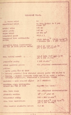

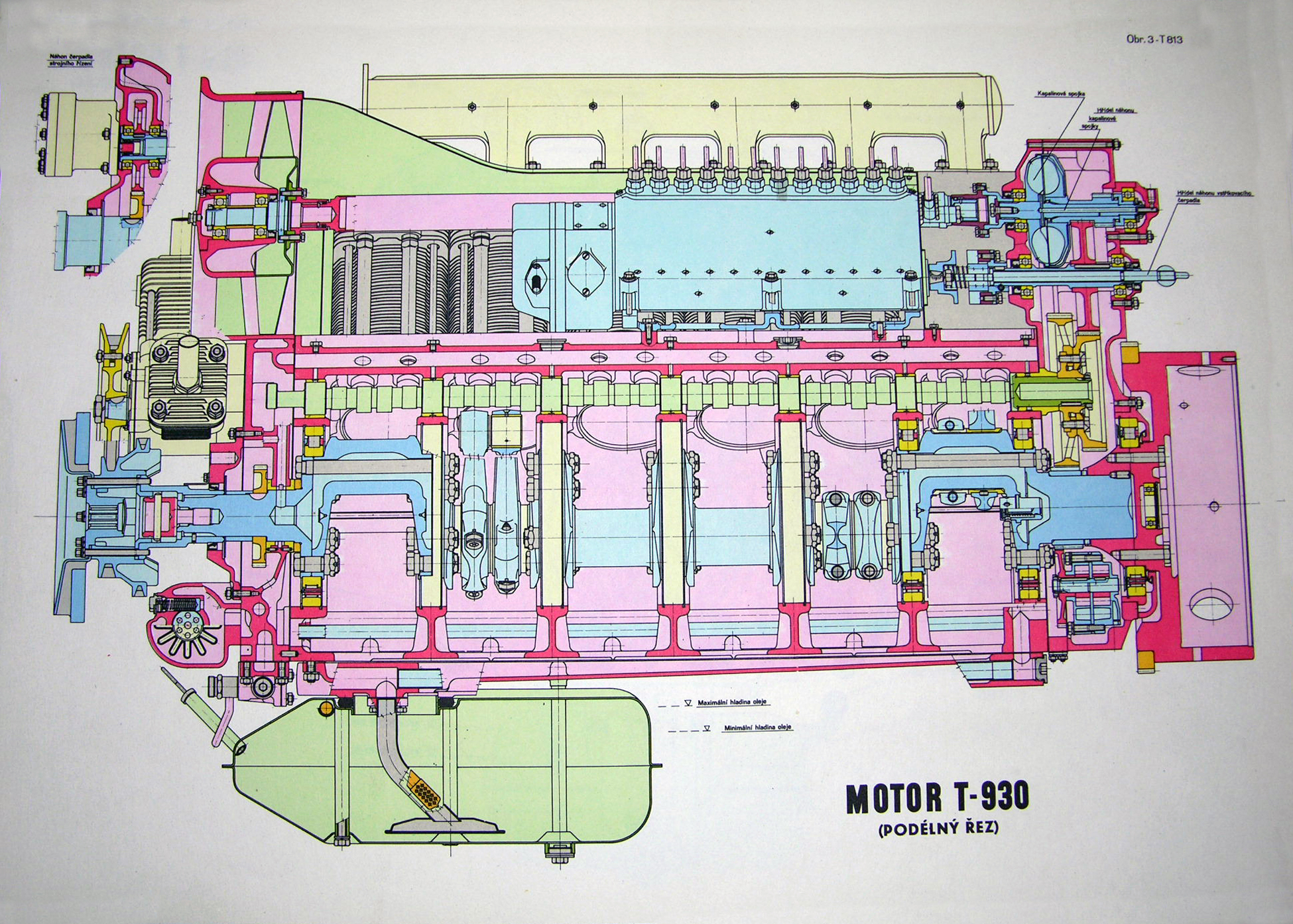

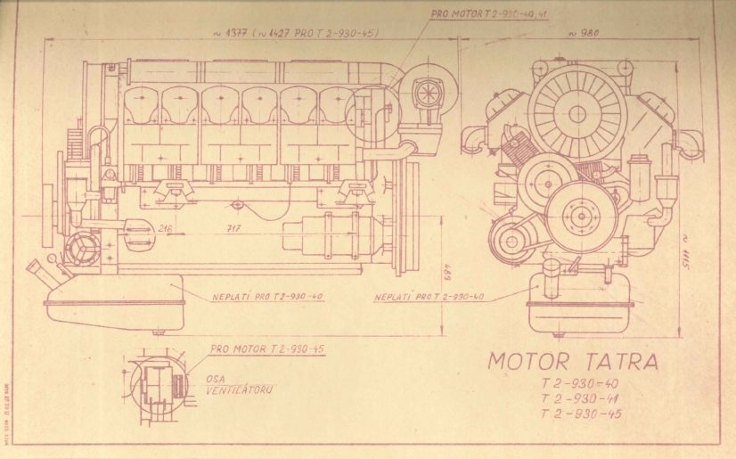

Re: Tatra 813 Kolos - engine type.
Hi,
I have just got hold of some technical information about the Turbo T930 V12 motor, it was in production but limited, more likely on prototype as turbos where very ineffeicent and with no intercooler ran the motor too hot.
Please wait I will upload asap having some problem with the images, sorry!
Bye
Malcolm
Bye
Malcolm
It would be interesting if some of the guys who run thier T813 on the Euro Truck Trial events could help here. They have retro fitted turbo..........I have seen this myself.........it gives them loads of extra hp.
There are a number of problems that need an anwser.
1. Do you use single or twin turbo?
2. Has a extra fuel device been fitted & how?
3. where does the oil feed come from to lubricate the turbo bearings?
4. Where is the oil piped to after lubricating the turbo bearings
5. Does anyone fit an intercooler, if so where?
Please see attached Tatra T2-930-40,41 & 45 info
