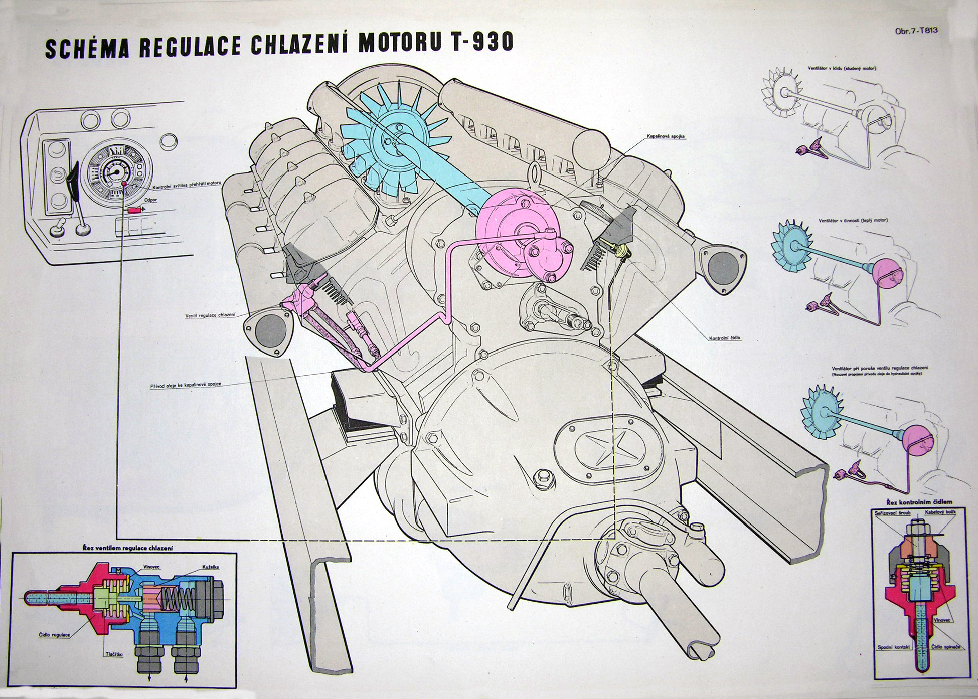

Tatra used a basic thermostat control sender (see attached diagram)to control the oil flow, it was unreliable so took it off(I have never seen one fitted). The new 928 motor has a basic electronic control system with thermo couple probes in the cylinder heads.......it will take a good bit of writing to exsplain so email at malc.doug@yahoo.co.uk if you want more info/photos.
Basically the system works like this - the oil is up to operating temp, the engine is under low load the oil to the fan coupling is closed, if the oil/cylinder head exceeds operating temp the oil flow is open so to power the fan even if the oil is cold.

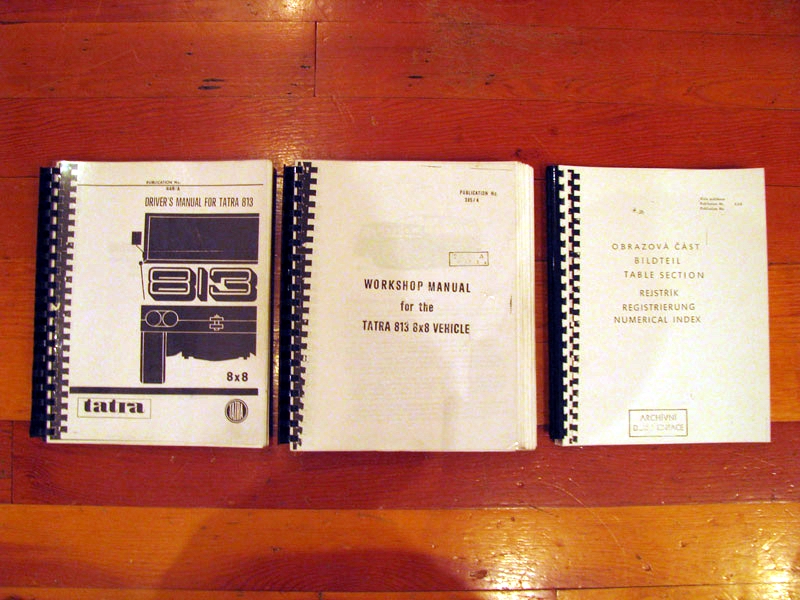

I have manuals, pics attached
Diver's Manual for Tatra 813 (English)
Workshop Manual for the Tatra 813 8x8 Vehicle English)
Obrazova Cast Bildteil Table Section Rejstrik Registrierung Numerical Index (Drawings and part #s only)
I wonder if my oil is circulating under temp like you have suggested.

I posted some pics of the Tatra manuals I have. I could not find any information regarding the adjustment of the winter blanket. Your point of a faulty oil flow regulation system is very interesting. What would you recommend I do to inspect it's functionality?

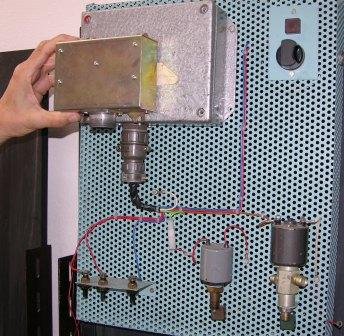

The second system is the T815 method with a small ECU controller, sensors, warning lights electro-magnetic switches etc. The whole system is around GBP500 and you still need to drill the cylinder heads, fix the warning light and do the wiring etc, please see attached photo.
The driver manual you have posted is very useful but limited, the problem with Tatra 813 manuals you need all of them to see the whole picture so to speak.
I spent 3 years collecting all the info availible about the T813, it takes up 3 cd's!
